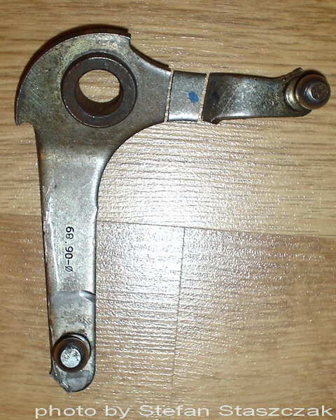

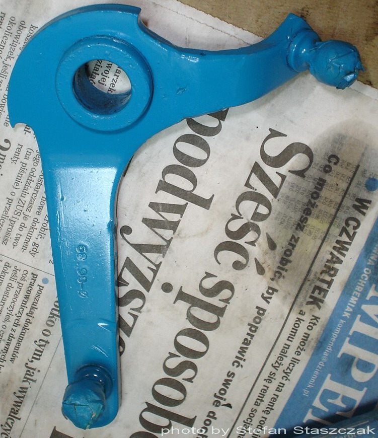

Post autor: stef »
Skrocilem 15mm, a wyglada to tak:)
